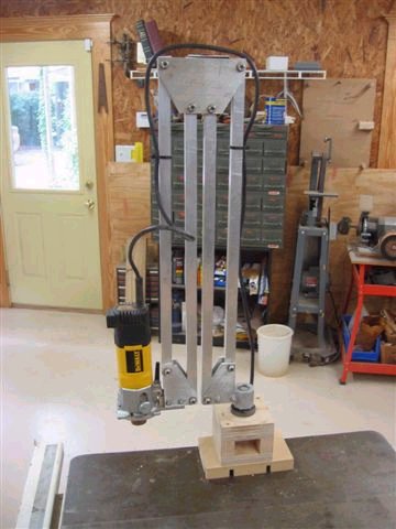

Like Paul, I feel more comfortable moving the router.
I built a jig like Arnt's (which is really impressive!), but the old saying about
fool-proof" was coined for guys like me. I found a way to screw up the operation of that jig. It is inherently top-heavy, and I was able once (or twice) to let the bearings slip away from the side...the router tipped in, and made a deeper cut than wanted.
I then made a jig like the one I hope to picture here.
It came from LINT and enjoyed several incarnations. Hope this makes sense:
The design is borrowed from those armed lamps that move about on the workbench, while holding the lamp in the same plane. This jig just holds a router.
